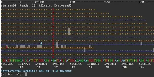

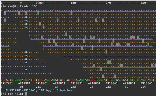

ASCIIGenome (I'm the author) has a command, filterVariantReads, designed to inspect reads having a variant at a position or range. It would go along these lines:
ASCIIGenome -fa genome.fa aln.bam
Then go to the region of interest and use:
goto chr9:4917981-4918161
filterVariantReads -r 4918011
From this:
You get:
You can also print to screen or save to file the underlying sam records with:
print > reads.sam
For several regions, the whole process can be scripted for automation.
Hope this helps!
