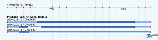

I found one similar example in an Arabidopsis annotation file. It is case of the cpuORF (CONSERVED PEPTIDE UPSTREAM OPEN READING FRAME ). Although the first and the third mRNA isoforms are identical, they repeated the mRNA isoform and name them differently to accommodate the additional ORF/CDS. I guess this is another way to do it. enter image description here
See the ranges for AT5G03190.1 isoform and AT5G03190.3 isoform.
Chr5    TAIR10  gene    758374  760382  .   +   .   ID=AT5G03190;Note=protein_coding_gene;Name=AT5G03190
Chr5    TAIR10  mRNA    758374  760382  .   +   .   ID=AT5G03190.1;Parent=AT5G03190;Name=AT5G03190.1;Index=1
Chr5    TAIR10  protein 758793  760148  .   +   .   ID=AT5G03190.1-Protein;Name=AT5G03190.1;Derives_from=AT5G03190.1
Chr5    TAIR10  exon    758374  760382  .   +   .   Parent=AT5G03190.1
Chr5    TAIR10  five_prime_UTR  758374  758792  .   +   .   Parent=AT5G03190.1
Chr5    TAIR10  CDS 758793  760148  .   +   0   Parent=AT5G03190.1,AT5G03190.1-Protein;
Chr5    TAIR10  three_prime_UTR 760149  760382  .   +   .   Parent=AT5G03190.1
Chr5    TAIR10  mRNA    758374  760382  .   +   .   ID=AT5G03190.2;Parent=AT5G03190;Name=AT5G03190.2;Index=1
Chr5    TAIR10  protein 758539  760148  .   +   .   ID=AT5G03190.2-Protein;Name=AT5G03190.2;Derives_from=AT5G03190.2
Chr5    TAIR10  exon    758374  758660  .   +   .   Parent=AT5G03190.2
Chr5    TAIR10  five_prime_UTR  758374  758538  .   +   .   Parent=AT5G03190.2
Chr5    TAIR10  CDS 758539  758660  .   +   0   Parent=AT5G03190.2,AT5G03190.2-Protein;
Chr5    TAIR10  exon    758843  760382  .   +   .   Parent=AT5G03190.2
Chr5    TAIR10  CDS 758843  760148  .   +   1   Parent=AT5G03190.2,AT5G03190.2-Protein;
Chr5    TAIR10  three_prime_UTR 760149  760382  .   +   .   Parent=AT5G03190.2
Chr5    TAIR10  mRNA    758374  760382  .   +   .   ID=AT5G03190.3;Parent=AT5G03190;Name=AT5G03190.3;Index=1
Chr5    TAIR10  protein 758539  758676  .   +   .   ID=AT5G03190.3-Protein;Name=AT5G03190.3;Derives_from=AT5G03190.3
Chr5    TAIR10  exon    758374  760382  .   +   .   Parent=AT5G03190.3
Chr5    TAIR10  five_prime_UTR  758374  758538  .   +   .   Parent=AT5G03190.3
Chr5    TAIR10  CDS 758539  758676  .   +   0   Parent=AT5G03190.3,AT5G03190.3-Protein;
Chr5    TAIR10  three_prime_UTR 758677  760382  .   +   .   Parent=AT5G03190.3
