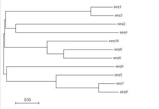

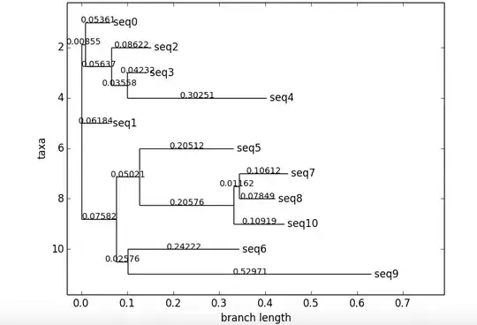

I am working on phylogenetic tree generation. I used BioPython and ClustalW 2.x.x for this purpose. I have generate the tree using BioPython but when I try to generate tree using "MegaSoftware GUI" tool my tree does not matched with the output of MegaSoftware.

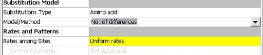

When I use "No. of difference" model then results are matched with biopython tree Like below image shown.
But whenever I choose "p-distance" model my results are not matched.
Output MegaSoftware using p-distance
Output BioPython
