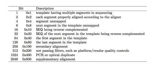

But looking at the explanation in this website: https://broadinstitute.github.io/picard/explain-flags.html
It labels 0x200 as read fails platform/vendor quality checks.
If we have reason to believe that soft clipping can happen for some of the alignments, should we just ignore the fact that IGV calls this fail QC? Does the failQC tag come from the SAM/BAM specification or is this something IGV came up with?
The SAM/BAM specification labels 0x200 the same way as the Picard flag explaining website:
The question remains as to why BWA-MEM uses the 0x200 flag for softclipping notation rather than Fail QC.

bwa mem is using exactly the same meaning of the 0x200 flag as every other program, including picard. Don't blindly assume that that entry in the header file relates to the output flags in the SAM output. If you search the code, you'll see that bwa is using this internally as a flag for "this alignment is soft-clipped", which it handles differently for primary and secondary alignments (hard-clipping the latter).
For what it's worth, bwa mem (at least the version I just tried) doesn't set the QC failed flag. This behavour is actually pretty common among aligners, since Illumina has changed how they represent QC failure at least once.

The connection between soft clipping and a read level flag is interesting. Soft clipping occurs at a per base level and is denoted in the CIGAR string. The failQC flag is applied to a read and usually comes directly from the sequencer. It is likely that BWA just named their internal var weird.
The failQC flag is part of the Sam Spec.
If you expect soft clipping I would suggest trimming that sequence from the reads prior to alignment. Also you can look at read in the input reads and see if the failQC flag is set prior to alignment to understand where it is getting set. IGV is just displaying what is in the BAM file not making any decisions about those reads.
