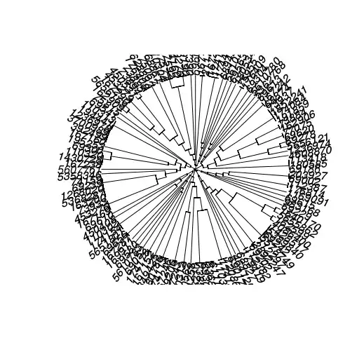

If I do a clustering of the pathways using the Dice coefficient matrix I don't know where (or how) to cut.
circular dendrogara
I tried using the height to select the pathways. But I am unsure of the interpretation of height.

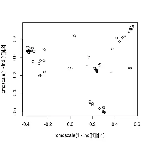

Some other tools I have seen use a multidimensional scaling plot, but I am not sure if performing it and cutting at certain point of the first dimension would help. MDS plot
