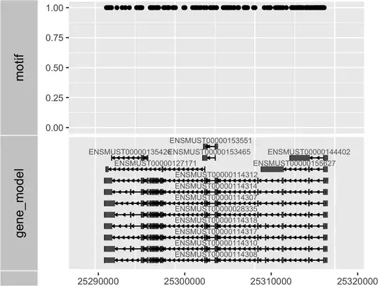

If I understand the question correctly, you'd like to plot the positions of the matches to you motif along with a gene model that shows the positions of introns and exons for the different transcripts. This can be accomplished fairly easily with ggbio:
library(EnsDb.Mmusculus.v79)
library(ggbio)
library(biomaRt)
library(stringr)
library(dplyr)
plot gene model with ggbio
gene_model <- autoplot(EnsDb.Mmusculus.v79, ~ symbol == "Grin1")
ensembl <- useMart("ensembl", dataset = "mmusculus_gene_ensembl")
You need the full length gene sequence to match the gene model
seq <- biomaRt::getSequence(id = "Grin1", type = "mgi_symbol", seqType = "gene_exon_intron", mart = ensembl)
retrieve position of gene in genome to match up with gene model
gene_start=biomaRt::getBM(attributes=c("start_position"), filters = 'external_gene_name', values = 'Grin1', mart=ensembl)
use stringR to find positions of exact matches
motif <- "ggcc" motif_positions <- as.data.frame(str_locate_all(seq$gene_exon_intron, toupper(motif))) %>% mutate(start=start+gene_start[[1]]-1)
make plot similar to Llopis's answer
motif_plot <- ggplot(motif_positions, aes(x=start)) + geom_point(y=1) + scale_y_continuous(limits=c(0,1))
combine plots
tracks(motif= motifs, gene_model=gene_model)
Gene Model with Motif matchs
This gives all motif matches for the gene sequence, not just the transcripts. It would be quite straightforward to filter out positions that overlap introns

    I couldn't remember the name of the package ggbio (I was beginning to doubt it existed). This is far more informative than my answer (+1) BTW, It might be better to overlap the plots of the gene model and the motif, with different colors – llrs Sep 26 '17 at 20:28

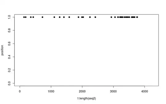

I assume you have the sequence in seq1:
# Set the input
seq <- getSequences("GRIN1")
motif <- "ggcc"
# Convert to lower case
seq2 <- tolower(seqinr::s2c(as.character(seq)))
istarts <- seq(from = 1 , to = length(seq2), by = 1)
# Create words of the same size as the motif
oligos <- seq2[istarts]
for (i in 2:nchar(motif)) {
        oligos <- paste(seq2, seq2[istarts + i - 1], sep = "")
# Remove exceeding words (words with NA, might need tweaking to motif size
oligos <- oligos[-c(length(oligos):(length(oligos)-nchar(motif)+2))]
# Find motif in the sequence
hits <- grep(motif, oligos, ignore.case = TRUE)
#Prepare the plot
positions <- ifelse(1:length(seq2) %in% hits, 1, 0)
plot(1:length(seq2), positions, col = c("white", "black")[position+1], pch = 19)
The plot is not the density, but you can choose how to plot it now, as you might be interested in windows sizes of 5 nucleotides or 20. positions where the motif is found in a sequence
From here you can iterate through multiple sequences. If you want to find several motifs you can take advantage of the oligos object if they are of the same size.
There is the seqPattern package in Bioconductor for more advanced pattern matching. But surprisingly it doesn't have this simple motif search. I think it would be easier to do this with perl and pyhton than in R.

  • I fixed the error in getSequences(). You will need to change your first line of code to seq <- getSequences("Grin1", "cdna") and then also alter this line to seq2 <- tolower(seqinr::s2c(as.character(seq$cdna))), assuming the seqType of interest is "cdna". I think the final line has a typo: the variable is positions not position. – syntonicC Sep 25 '17 at 15:00
