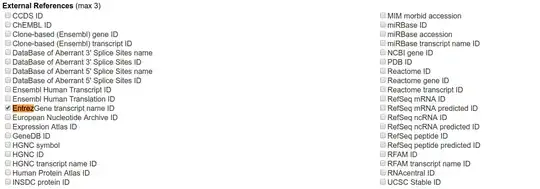

Well, I'm trying to convert a list of Human Gene referenced by Ensembl Gene IDs to Entrez Gene IDs. I have been advised to use biomart.
I tried to get a kind of conversion table for all human genes. I don't know if my settings are wrong, but I didn't find any checkbox for Entrez Gene Id in the section Attributes > External References. I've just found the Entrez transcript name ID (see below), but it's not what I need.
How can I use biomart for such a conversion?
Edit:
According to this video tutorial EntrezGene ID should be an option in biomart (see screenshot below).
That video tutorial is outdated.
floatingpurr
  • 315
The ID you need is the NCBI gene ID, which is the same as the EntrezGene ID.
Ian Sudbery
  • 3,311
  • Thank you Ian, it seems working. Anyway, there is no a one-to-one matching (i.e., some Ensembl IDs do not have an NCBI counterpart). Is it normal? – floatingpurr Sep 06 '17 at 11:29
    Yes. See my answer to your other question. https://bioinformatics.stackexchange.com/a/2474/235 – Ian Sudbery Sep 06 '17 at 11:59
