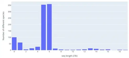

Those sequences vary a lot in size, here's an histogram of the number of species I have data for enter image description here As you can see I have a lot of sequences with length [12k-15k bp] and [15k-18k bp] (values on the x axis are scaled by a factor of 3000 and then rounded). I would like maximise the species genetic information.

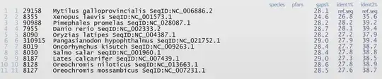

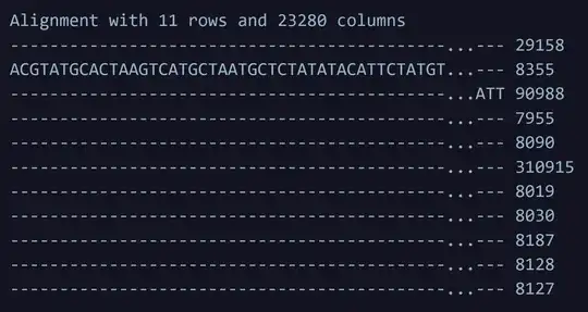

When I try to align 10 sequences drawn from the [15k-18k bp] range I get this result (the numbers on the right are the TaxID of the species).
enter image description here We can't see much here so I used an online MSA viewer [https://alignmentviewer.org/] enter image description here

It looks like these are random mitochondrial sequences pulled from NCBI, which is probably why the alignments aren't working well.
As a starting point, I recommend you make sure that all the mitochondrial DNA sequences are rotated and reverse-complemented as necessary to make sure that the same gene matches position 1 of the sequence. I prefer doing this for COX1, because it's a well-conserved gene. After doing that, it'll be much easier to look at the alignment of that gene alone, which will give you an idea of the complexity of extending the task to the full length of the mitochondrial genome.
I don't expect you'll find a long exact-match sequence that is consistently conserved across all species, even within COX1. It wouldn't surprise me if the longest conserved sequence were less than 16bp, with a few repeats of that sequence throughout the genome. If that is the case, you need to think about what to do with that information. Given the complexity of this intermediate problem you've asked about, it would be a good idea to think first about what you would do after you discovered there were no such sequence.
