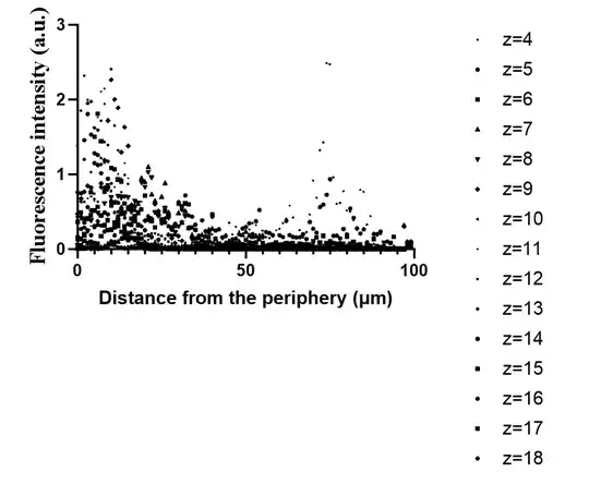

I have to establish the penetration profile of particles in tumour spheroids.
For this I have spheroids composed of cells which were exposed to particles, both of which are fluorescently labeled. The spheroids were then imaged using a confocal microscope by taking z-stacks of all spheroids. For analysis, I determined the intensity profile of each focal plane using an ImageJ plugin, namely "distribution_shapes".
What should be done next?
I currently did not find any step-by-step guide for this analysis for manual assessment and any type of help would be greatly appreciated.

    This is actually what I was using to determine the intensity profile of my particles. However, I am not sure what to do next, because I have the intensity profile of a spheroid over z-axis and don't know how to put the information together or to visually represent the quantification of the penetration profile. – Timi Sep 13 '23 at 11:11
  • @Timi thanks for clarification. Can you post what your data look like (just a snippet is probably enough)? That might be something we can help with. – Maximilian Press Sep 13 '23 at 17:35
  • I added a screenshot of how to profile intensities look across a z-stack (1st image) and how the average profile intensity looks like in the last 5 focal planes in the z-stack. This is what we are aiming to get. The papers that I found that do something similar are: https://www.sciencedirect.com/science/article/pii/S0168365921006672 https://www.ncbi.nlm.nih.gov/pmc/articles/PMC7824314/ , but they also don't go into details, and the script in Matlab is not working for me. – Timi Nov 01 '23 at 15:35

The next step depends heavily on what your question is. Some general ideas, not specific to tumor particle penetration.
  1. Your current visualization seems OK to me, if you want to make some features more obvious you can try density estimation.
  2. If you have a generative model (for example you believe this is a mixture of a "shallow" and "deep" Gaussian distribution, or you have reason to believe the particles follow an exponential distribution), you can fit your data to this distribution and estimate its parameters.
  3. If you want to compare conditions without too strong assumptions on the distributions, you could compute the cumulative distribution of the particles. There are statistical approaches to compare such curves.
  4. To compare conditions, you might even be able to come up with a simpler metric, for example "total fluorescence in the core of the spheroid" normalized by "total fluorescence in its periphery".
Ultimately it all depends on your research question (are there treatments to compare to each others, biological replicates whose consistency you want to check, known structure within the tumor spheroid, a time course, ...). My suggestions above would be easier to implement in R/Matlab/Python than pure ImageJ.

    I want to compute the cumulative distribution of the particles. But I don't know how to do this with a z-stack as the distribution across z-direction will not be the same as in x and y-directions. I also don't have any knowledge of programming, that's why I was wondering if anyone knows a guide or course that can help in this regard. I did find a matlab script, but I get the same errors and I asked several people to help me with that and we didn't manage to solve it. – Timi Nov 23 '23 at 09:05
