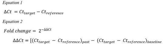

The steps to calculate fold-change:

About this statement: "The key question, which is standardisation and I would say it is essential for RT-qPCR derived data at a minimum to at least investigate consistency of signal against a control. That minimum is what the second equation describes (why it works is complicated)."
I don't really understand what you mean standardize at a minimum. The endogenous control genes we are using are individualized for every sample. Let say we are investigating the fold-change in the individual i and the variable k. We are using endogenous controls in the i individual to "standardize" values. The

Overall, I am now clearer one part of the calculation: this is essentially an ad hoc statistic to assess fold-change of the raw Ct via a single /minimal PCAs following one or more standardisations.
What you are measuring is the optimised multi-dimensional variance of the fold-change of raw Ct after at least one or else numerous standardisations. So this is not the actual fold-change of Ct, but variance of the fold-change derived via Eigen values.
If you are clear about that and what this represents and the reader is clear about this then it would be up to the reviewers.
