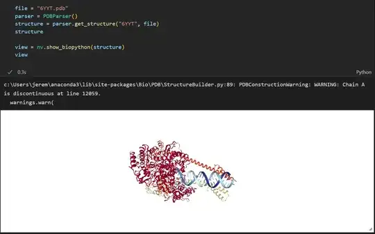

Update: Recently I found out that I can visualize the protein using nglview.show_file() instead of using nglview.show_biopython(). Even though I can visualize proteins now and technically my problem has been solved I would still like to know why the show_biopython() function isn't working properly.

I also figured out another way to fix this problem. After going back to the tutorial I was talking about I saw that it was made back in 2021. After seeing this I wonder if we were using the same verions of each package, turns out we were not. I'm not sure what version of nglview they were using, but they were using biopython 1.79 which was the latest verion back in 2021 and I was using biopython 1.80. While using biopython 1.80 I was getting the error seen above. But now that I'm using biopython 1.79 I get this enter image description here
So I guess there is something going on with biopython 1.80, so I'm going to stick with 1.79

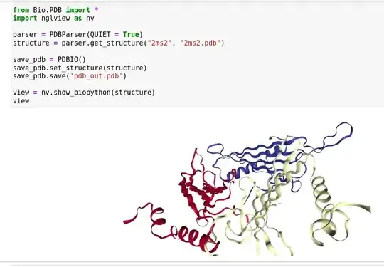

I had a similar problem with:
from Bio.PDB import *
import nglview as nv
parser = PDBParser(QUIET = True) structure = parser.get_structure("2ms2", "2ms2.pdb")
save_pdb = PDBIO() save_pdb.set_structure(structure) save_pdb.save('pdb_out.pdb')
view = nv.show_biopython(structure) view

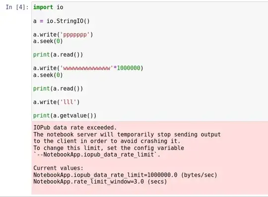

if I uncomment the print statements I'll get the :
IOPub data rate exceeded.
The notebook server will temporarily stop sending output
to the client in order to avoid crashing it.
error , but commenting them out I get:

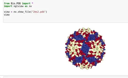

while using thenglview.show_file(filename) I get:
tha's because, as could be seen looking at the pdb_out.pdb file
outputted by my code, Biopytho.PDB.PDBParser.get_structure(name , filename) doesnt retrieve the pdb header responsible for generate full CRYSTALLOGRAPHIC SYMMETRY/or biopython can't handle it (not sure about this, help if you know better), but just the coordinates.

it could be something related to jupiter ipykernal ? hope somebody could shed more light into this, dont know how the framework runs, but is definitely different from a normal python interpreter. As an example:
Same code in one of my Python virtualenv, will run forever, so it could be ipykernel dont like StringIO()s or do something strange to them ?

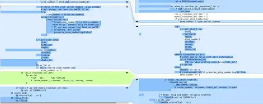

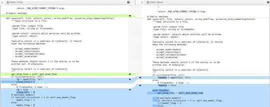

OK thanks to the hint in the answer below, I went inspecting PDBIO.py in github repo for version Biopython 1.80 and compared the save method of PDBIO : def save(self, file, select=_select, write_end=True, preserve_atom_numbering=False): with the one in Biopython 1.79,
see first bit: enter image description here
and last bit: enter image description here
so apparently the big difference is the with fhandle: block in version 1.80.
So I realized that changing adaptor.py with adding a subclass of StringIO that looks like:
from io import StringIO
class StringIO(StringIO):
def __exit__(self, *args, **kwargs):
    print('exiting from subclassed StringIO !!!!!')
    pass
and modifying def get_structure_string(self): like this:
        from Bio.PDB import PDBIO
        #from io import StringIO
        io_pdb = PDBIO()
        io_pdb.set_structure(self._entity)
        io_str = StringIO()
        io_pdb.save(io_str)
        return io_str.getvalue()
was enough to get my Biopython 1.80 work in jupiter with nglview.

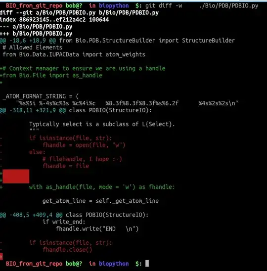

  • think solution could be like PDBParser handles it: from Bio.File import as_handle , https://github.com/biopython/biopython/blob/7ef56557bdca66eabd62334e61c4dc3153c997ff/Bio/File.py#L29 and in PDBIO.py save method change with fhandle: to with as_handle(fhandle): – pippo1980 Dec 16 '22 at 12:22
  • or remove if isinstance else ... and change with fhandle: towith as_handle(file, mode = 'w') as fhandle: – pippo1980 Dec 18 '22 at 00:36
tried to understand git, I ended up with this, seems more coherent with the previous habits in the biopython project, but cant push it.
Anyone could pass it along ? [of course needs to be checked out, my tests are OK, but I am a novice].
