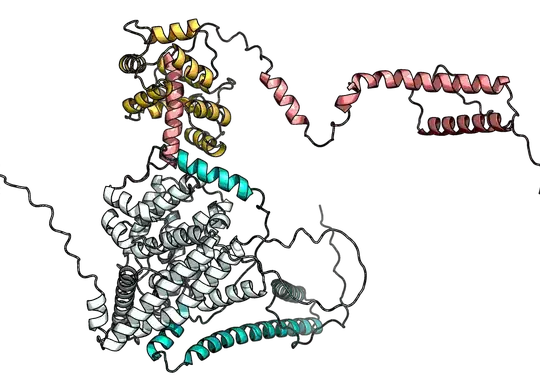

The last paragraph sounds like an exaggeration, so I best give an example. Here is an example for the drawer from today. A target protein (catalytic domain = pale) has a regulatory terminal which inhibits in isolation (terminus = turquoise), however, when modelled with another protein (mustard) this terminal (terminus = coral) is flipped away. Thus revealing the mechanism by which the mustard protein sequesters the regulatory helix (coral), which would otherwise (turquoise) inhibit the catalytic domain (pale cyan). In the literature, this is a western blot. Where a variant of interest involved in this mechanism one state may be more energetically favourable by scoring the ∆G of the different "snapshots" (=static conformers). complex
