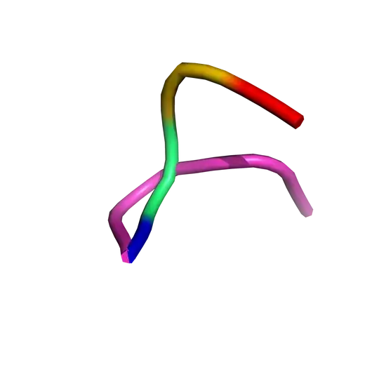

here an image of the original vs new quadripeptid (cartoon repr, just backbone) :
original is rainbowed one (blue to red), magenta is the new one
saved as atom_coord.pdb
