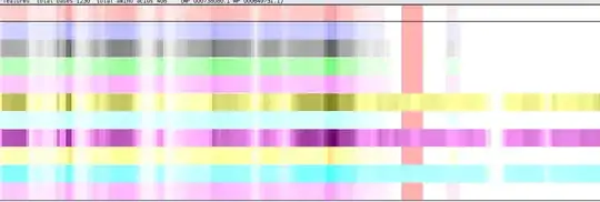

in the end, I just loaded the .bam files into artemis and, by inspecting the depth (heat-map), I could check which samples had the genes I was looking for:
