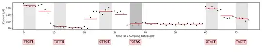

What I found related to my own question: I guess I was not completely correct in the terminology I was using, which might cause confusion. In nanopore sequencing, translocation duration refers to the time a fragment of DNA/RNA passes through the nanopore. Also for better visualization, I made this plot after running albacore basecaller:
as @gringer has explained, the block stride value is fixed (=5). The figure shows a small portion of albacore Event Table: The x-axis corresponds to the relative time from the start of measurements and the y-axis shows the current level. Each black dot shows a single measurement from an ONT device; the dots are segmented by a set of block strides (=5) used by albacore to call an event. The red lines show the average of the measurements in one segment. The shaded area in light gray represents the event that resulted in calling a base (one to one). Dark gray areas show events that resulted in calling two bases (split events). The white area corresponds to events with no called bases (skipped events). The boxes below the x-axis correspond to bases called in shaded areas and the bold base is the base that is called for that event.
