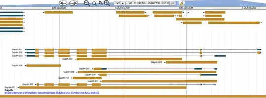

I'm not quite sure what you're asking, but pretty much anything can happen in terms of exons and transcripts:
  • Two different genes encoded on different strands can share the same genomic region as an exon
  • Two different genes encoded on the same strand can share the same genomic region as an exon (including identical exon boundaries)
  • A gene can have multiple transcript isoforms that share the same genomic region on the same frame
  • A gene can have multiple isoforms that share the same genomic region in different frames
  • Genes can have variable regions which are modified during somatic development (e.g. T-cell and B-cell receptors)
  • Gene transcripts can be spliced together in different orders in different isoforms
  • Exons from one transcript isoform can overlap with exons from another isoform (but not necessarily cover identical regions)
  • Stop codons can occasionally be "read-through", resulting in a longer protein/peptide than the expected translation
As an example of different isoforms within the same gene exhibiting different translation mechanisms, here are graphical representations of annotated transcript isoforms for Gapdh on the mouse GRCm38 assembly, created in JBrowse. I wouldn't put complete trust in any of these (especially not the ones that have no defined intronic regions), but it's a useful demonstration of the types of things that can happen. Compare, Gapdh-207, where an untranslated region starts halfway through an exon, and Gapdh-209, where the translated protein starts halfway through an untranslated exon in Gapdh-207:
Gapdh isoforms, showing overlapping exons
If there is a situation where it seems like exons from the same isoform have overlapping regions, it might be worth looking elsewhere in the genome to see if there's a transcribed gene copy somewhere. That, at least, doesn't seem to be something I'd expect to happen through the normal translation process.

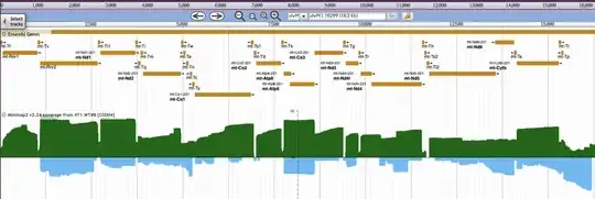

Also, don't expect annotations to be complete. Even on something as [presumably] well-studied as the mouse mitochondrial genome, we can identify clear transcript start/stop points from long polyA cDNA sequences that are completely absent in the genome annotations. This is most obvious for the completely unannotated reverse strand (e.g. transcript starting at around 16,200bp), but also happens on the forward strand as well (e.g. coverage steps within mt-Nd5):
