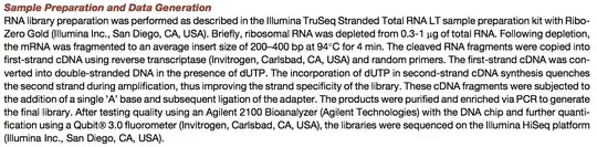

Recently, I have downloaded a publicly available dataset, which are 350 tumor samples. I see the following information from the published paper.
They used Ribo Zero Gold and rRNA was depleted. Strand specific data. After aligning the data I did some alignment quality check with Qualimap RNA-Seq QC tool. I visualised the bam files in IGV. Alignment is good. For all samples 90% alignment rate was seen. I observed that in all samples Higher percentage of mapped reads were originating in Intronic regions. Followed by Exonic and intergenic regions.
