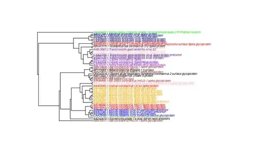

My working solution using this , this works as I did the alignment of sequences using full header name which kind of help to look for the pattern and grep it. The data file
I would still like to see the ggtree way instead of putting lots of label in the plot I would only like to see if I can annotate all the tips which have one organism source as one color rather putting all the labels

grep("Human",pars.a$tip.label)
length(grep("Human",ml.a.rooted$tip.label)
# thus there are 94 tip labels with that are designated TK (not TKL tyrosine kinase like)
# make a vector for each tip.label called tipcol with black on all of these...
#tipcol <- rep('black', length(tree$tip.label))
tipcol <- rep('black',length(pars.a$tip.label))
# make a vector with our list of kinase categories
#kinaseCats <- c("TK/", "TKL", "STE", "CK1", "AGC", "CAMK", "CMGC", "RGC")
kinaseCats <- c("Human","Rat","Murine","Bovine","Canine","Feline","Porcine","Gallus","Bat","Infectious","Transmissible")
# make a vector of color we want:
colorsList <-c("red", "darkolivegreen3", "blue", "orange", "blueviolet", "purple", "pink", "green","brown","navyblue","purple4")
# replace colours where grep gives "TK" as red, etc in a loop
#for(i in 1:length(kinaseCats)){
 # tipcol[grep(kinaseCats[i], tree$tip.label)] <- colorsList[i]
  tipcol[grep(kinaseCats[i], pars.a$tip.label)] <- colorsList[i]
# plot with edge length false to see nodes better
#plot(tree,
 #    use.edge.length = FALSE,
  #   tip.color=tipcol,
   #  cex = 0.25)
plot(pars.a,
     tip.color=tipcol,
     cex = 0.5)
# slow to draw due to text - a bit annoying!
nodelabels(cex=0.4)
figure plot
kcm

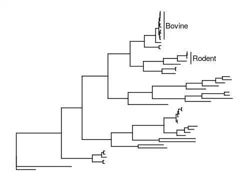

there are nice features in R ggtree package. You may use the geom_cladelabel() function for your purposes. But I haven't find yet a way to automatize clade annotation. To do it, you have to be sure of the clade homogeneity before removing tiplabs. here are some commands to do clade label annotation:
annot<-read.delim("annota.txt", header = T)
ggtr<-as.treedata(pars.a)
g<-ggtree(ggtr)
#find the node number corresponding to the common ancestor of the top clade in you tree
MRCA(ggtr, "AAL40400", "AAF25519")
#here, check that all accessions belong to the same organism/group
subset(annot, label=="AAL40400" | label=="AAF25519")
#in this case, sequences are related to bovine.
g<-g + geom_cladelabel(node=89, label="Bovine", align=F, fontsize=4)
plot(g)
#another example
MRCA(ggtr, "AAA46456", "AAF97738")
subset(annot, label=="AAA46456" | label=="AAF97738")
g<-g+ geom_cladelabel(node=73, label="Rodent", align=F, fontsize=4)
plot(g)
build with ggtree

    you may keep tip labels where clade are heterogeneous. Or you should consider smaller clades or consider larger taxonomic groups (eg I summarized mice and rats as rodents in the second example). In any case, i think it deserve a visual/manual inspection to ensure the correctness. – thomas duge de bernonville May 28 '20 at 08:31
  • okay so the better idea is to combine the larger taxa group.So first i have to find the node number then combine. Is it possible to give separate color to the clade? such as bovine one color then rodent other etc ..?okay the color can be done i saw the manual – kcm May 28 '20 at 08:41
    yes it is fully customizable. Finding the appropriate number is the more fastidious step I think. There is probably a way to automatize it however. – thomas duge de bernonville May 28 '20 at 08:44
    nodelabels(cex=0.4) this is how i can label the node in base R which i was doing it is the same for the object which is made using this "g<-ggtree(ggtr)" – kcm May 28 '20 at 08:46
    this a good thing to identify interesting node numbers! – thomas duge de bernonville May 28 '20 at 08:52
