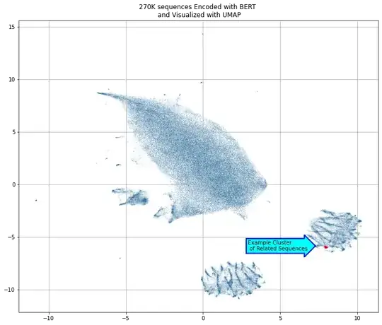

BERT is an amazing tool and I wondered if it could successfully model the language of the genome if it were encoded into "sentences" (I chose 7-mer words and sentences of length 64, arbitrarily). Below is the result of encoding the full genomes of human, bonobo, gorilla, chimp, and orangutan. There are about 270K "sentences" here. You can see there are four major blobs, with indications of small tight clusters. BERT has decided that the points indicated in red are somehow semantically related. I think is is significant, or at the very least interesting.
BERT UMAP visualization
My first thought was that clustering was trivial degenerate cases. Maybe all the "AAAAAAA..." were put near each other, and all the "TTTTTTTTT...." etc. I printed out samples from the clusters and visually that is not the case. Also I've made histograms of the average Levenshtein distance in groups. Within a tight group, the LD is statistically much lower (but not trivially low) as compared to unclustered regions (the big blob is all unclustered).

The UMAP results look very pretty :)
If I were to try to make sense of this blob, I'd try to do the following.
  1. Pull out Gene Ontology (GO) terms for a list of candidate genes (you can try to subset Uniprot / Swissprot for some examples). Then I feed through some genes through your fragmented BERT kmer approach to see where they land. I'd be particularly interested in seeing where transmembrane proteins and enzymes land here.
  2. I'd try to color this by introns vs exons (you should be able to extract this sort of information from your genome files). There is a good chance that the difference between introns / exons could explain some of these differences.
  3. It maybe worth looking into genes that only encode RNAs vs genes that encode proteins.
