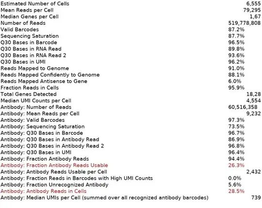

we performed a combined gene expression and CiteSeq experiment with the 10x VDJ kit and 20 conjugated antibodies and sequenced on hiseq. I used cellranger to process the sequencing output. The cellranger summary shows overall good values except for a low percentage of "Antibody Reads Usable" and a low fraction of "Antibody Reads in Cells". How is it possible that so few antibody reads are usable? Does this mean that most antibodies were not bound to the cell surface? cellranger metrics

  • Same issue here! I do not understand how could the fraction of usable antibody reads be so low if the valid ADT UMIs, cell barcodes and antibody barcodes are all close to 90% – Daliya Jan 31 '20 at 09:05
  • We have also seen a very similar issue and are also investigating why. Possibly of note, I tried forcing the cellranger program to assign a very large number of cells (10x the actual number of cells we had) using the --force cells option. This appeared to increase the % of usable Ab reads and Ab reads per cell metrics, suggesting that these reads may be associated with barcodes that have relatively few UMIs? – Mike Jan 17 '20 at 14:19
