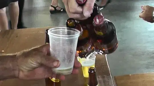

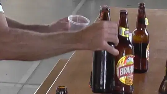

Bottles do not necessarily break or open. Seems to depend on the thickness of the glass. These three bottles stick together by ice. Brazilians love ice-cold beer.
Salt
  • 720
  • Brilliant. Do you know what beer this is ? Also, any reference on how the thickness of the glass can be measured ? Just want to know if I can chuck my beer into the freezer. – happybuddha May 15 '18 at 23:25
    In my case it was Brahma, the 600ml bottle, look 2nd photo. But I guess it will do there in Brazil with all 600 ml bottles, also from other breweries. Can't tell you about your beer. – Salt May 16 '18 at 00:52
