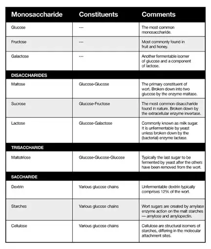

What is Sugar?
But before I can answer the questions above, I do need to lay some groundwork and describe the different building blocks. It won’t take long and once you understand what everything is made of, it becomes a lot easier to understand the answers. All sugars are carbohydrates, molecules that contain both carbon (carbo-) and hydrogen (-hydrate) atoms. Carbohydrates have the general formula of CnH2nOn, meaning they have one carbon (C) and one oxygen (O) to every two hydrogens (H2). In sugars, the “n” usually equals 5 or 6. For example, glucose has the formula C6H12O6, meaning it is constructed of six carbon atoms, twelve hydrogen atoms and six oxygen atoms. Incidentally, fructose also has the formula C6H12O6, but the atoms are arranged differently in the molecule.
The most common type of sugar is called glucose (aka. dextrose, blood sugar, corn sugar). Glucose is a monosaccharide, hexose-type sugar, meaning that it is a single molecule consisting of six carbon atoms. Other hexoses relevant to brewing are fructose and galactose. Elementally, these monosaccharides are all the same, but they are isomers of each other i.e., their chemical structure and arrangement gives them different properties. For instance, an isomer of glucose called fructose (also known as fruit sugar), tastes sweeter than glucose.
Let’s examine the sugars found in a typical beer wort made from 2-row barley base malt. The main constituent of wort is maltose, which typically comprises around 50% of the total carbohydrates in wort. This is followed by maltotriose, which comprises around 18% of the total carbohydrates. The remainder of the wort is made up of glucose (10%), sucrose (8%), fructose (2%) and finally assorted dextrins, which together account for 12% of the wort carbohydrates.
Maltose is a glucose disaccharide, which means that it is made up of two glucose molecules. Sucrose is another disaccharide and consists of one glucose and one fructose. Sucrose is a naturally occurring plant sugar, and is used as table sugar worldwide. Sources include sugar cane, beets, maple sap and nectar. Maltotriose is a trisaccharide consisting of three glucose molecules. Dextrins (aka. oligosaccharides) are larger carbohydrates consisting of more than three monosaccharide groups. Monosaccharides are sweeter tasting than polysaccharides. In descending order of sweetness: fructose is sweeter than sucrose, which is sweeter than glucose, which is sweeter than maltose, which is sweeter than maltotriose.
