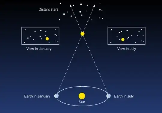

The currently accepted answer is not relevant for finding the distance to a star like Proxima Centauri.
Here's how parallax works. You measure the position of a star in a field of stars that are (presumably) much further way. You do this twice, separated by 6 months. You then calculate the angle that the star has moved against its background stars. This angle forms part of a large triangle, with a base that is equal to the diameter of the Earth's orbit around the Sun. Trigonometry then tells you what the distance is as a multiple of the distance from the Earth to the Sun. [In practice you perform many measurements with any separation in time and combine them all.]
The "parallax angle" is actually half this angular displacement, and a star is said to be 1 parsec away if the parallax angle is 1 second of arc. So 1pc is 1 AU/$\tan (\theta) = 3.08\times10^{16}$ m. The larger the parallax, the closer the star.
The Gaia satellite is currently mapping the entire sky and will estimate tiny parallaxes with precisions of $10^{-5}$ to $10^{-4}$ arcseconds (depending on target brightness) for about a billion stars.
Parallax - as illustrated at http://www.bbc.co.uk/schools/gcsebitesize/science/21c/earth_universe/earth_stars_galaxiesrev4.shtml

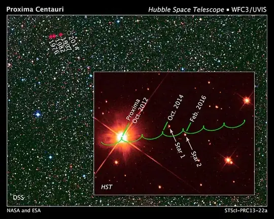

Now in reality, it is a bit more difficult than this because stars also have a "proper motion" across the sky due to their motion in our Galaxy relative to the Sun. This means you have to do more than two measurements to separate out this component of motion on the sky. In the case of Proxima Centauri the motion against the background stars due to proper motion is larger than the parallax. But the two components can clearly be seen and separated (see below). It is (half) the amplitude of the curved motion in the picture below that corresponds to the parallax. The proper motion is just the constant linear trend with respect to the background stars.
HST images of the path of Proxima Centauri against background stars. The green curve shows the measured and predicted path of the star against the background field over the next few years.
HST images of Proxima Centauri

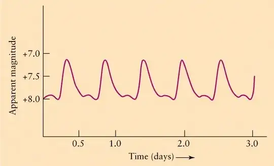

One way to find distance to a collection of stars is to hope for an RRLyrae in the bunch. Since RRLyrae are standard candles, you can use the inverse square law to extract the distance.
rrlyraePeriod
