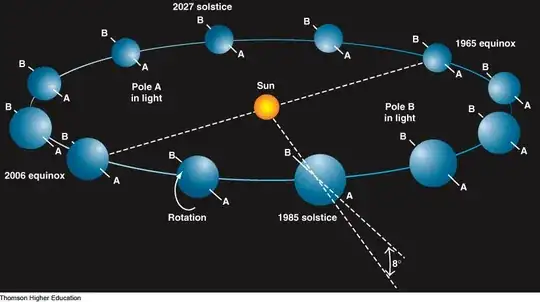

Pretty much like this diagram of Uranus' rotation (from Source: University of Hawaii:
