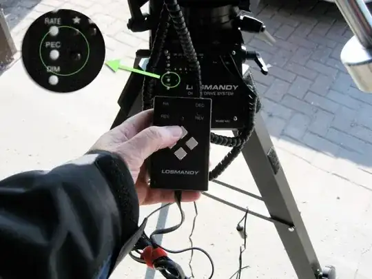

Training PEC with hand-control Most mounts intended for astrophotography include a feature called Periodic Error Correction (PEC), which can be used alone, or in conjunction with Autoguiding. PEC is used in two phases:
- Training. During this phase you use the control panel or menus to say "Hey! Pay attention to this!" to the mount, then you manually keep a star perfectly centred for several worm periods. You do this by centering a star with a high-magnification eyepiece that includes a cross-hair reticle. You then stare at the star for 10 to 15 minutes and use the mount's hand controller to manually make the small adjustments necessary to keep it perfectly centred on the cross hair. The mount records the error corrections you supply, remembering where in the worm position each one was needed. By training through more than one worm cycle, the mount can record an average correction, in case you reacted slowly or over-reacted.
- Playback. Once you have trained the mount, you can turn on PEC. The mount will "play back" the recorded error correction information by slightly changing the speed of the Right Ascension drive to move ahead or back each time your manual error corrections did the same. This will cancel the periodic error, resulting in a smoother track.
Training PEC with hand-control: Periodic Error Correction (PEC) button on the control panel of an equatorial mount.
