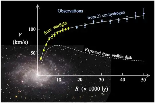

Measuring $G$ in terms of parsecs (or light-years) and $(\mathrm{km}/\mathrm{s})^2$ would be more convenient any time one is dealing with galactic-scale distances, such as in the galactic rotation curve:
(Image from Wikipedia).

Nice. The example of the galactic rotation curve is a gem; I hadn't thought of that. – HDE 226868 Nov 15 '14 at 23:56
