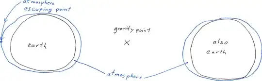

Also your weight (stepping on the bath scale) would vary depend on where on the planet you are. If you on the side facing the other planet you would be heavier than on the other side of the planet. Another point that would be possible, but I will point out I am not completely sure about this. The planets would struggle keeping their atmosphere for a long period of time because of the rotation. The side facing away from each other would have thicker atmosphere than on the sides (see my sketch).
Sketch
(source: directupload.net)
At this point the gravitational pull of the planet is also lower then everywhere else. This could help the molecules to escape the Earth, in a long period of time.

  • Thanks for the great answer. (I love the diagram, by the way!) The tidal-locking would clearly be problematic for native life forms. The part of the answer I would question is the final part about the atmosphere. Is the suggestion that the atmosphere would be lost to centrifugal force, due to orbiting the common center of gravity? (or am I misunderstanding?) – Syzygy333 Oct 23 '14 at 20:57
  • If you on the side facing the other planet you would be heavier than on the other side of the planet. Are you sure about that? That's not how the tidal force works. – PM 2Ring Feb 21 '19 at 10:55
