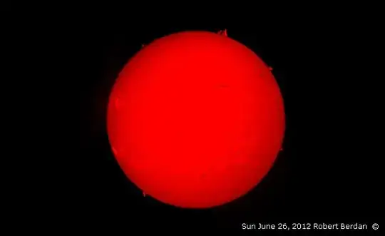

Yes, there are filters which do block out the vast majority of light from the sun. I think it's actually only a very small (~1 angstrom) wavelength band of light which gets through. You can see some pretty amazing features, including sunspots, and solar flares. Here's a composite image as an example (taken through a Hydrogen alpha filter):
suncomposite_halphafilter
Those smallish looking edge features are solar prominences which are large enough to swallow up multiple Earth's. This is not too far off from what you could observe with a solar scope.
