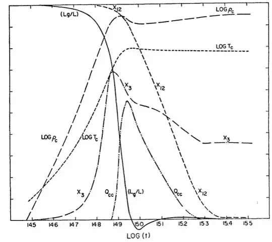

  4. Finally, the conditions in the core are extreme enough for fusion to begin. The timescale from all the energy being provided by gravitational contraction to all the energy being provided by fusion, is on the order of 1 million years. The star's luminosity (counter-intuitively) decreases again when this happens, as the energy from fusion doesn't quite offset that from gravitational contraction, which ceases when fusion begins.
Figure: the The Lg/L curve describes the amount of energy gained from gravitational contraction over the total luminosity of the star. The logarithmic time axis is in seconds (reproduced from Iben (1965), Figure 3).
