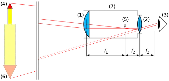

A refractor telescope does not sharpen the image per se. The convex lense concentrates the light rays, not unlike a magnifying glass. To actually focus the enlarged image on your retina, you need an eyepiece, which is another bi-convex lense (in its most simple form). This will re-align the light rays after they passed through the primary focus. See this image for a visual explanation:
Light ray sketch for a refracting telescope Source: Wikipedia
The above image also explains why the image of a refracting telescope appears upside down. You don't need (or want!) any prisms in this kind of setup.

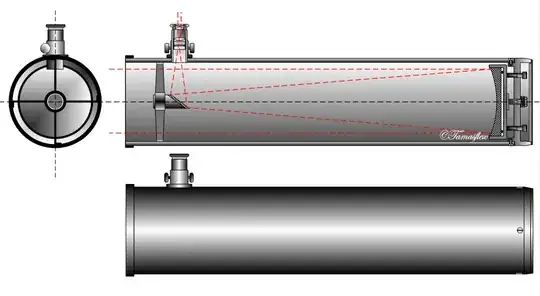

On the other hand, a reflector telescope uses a concave mirror plus an eyepiece. There are different configurations, but one of the most simple and most common ones is the Newtonian telescope:
Newton telescope ray diagram Source: Wikipedia
So instead of refraction of light by a lense, we use the reflection of light on a mirror, to enlarge the image. Focusing on the retina is again done by an eyepiece in the same way as with the refracting telescope.
The advantage of refracting telescopes is that there is no obstruction in the optical path inside the telescope. This is not the case with reflector telescopes. They usually have a secondary mirror in the middle of the optical paths, hence reducing light gathering performance.
On the other hand, reflector telescopes are often much lighter, and cheaper to assemble. Also, very compact models of reflector telescopes can be built.
