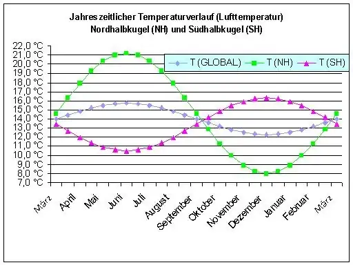

But I think that's pretty boring. Don't you? So let's calculate how eccentric Earth's orbit would have to be for it to have seasons without axial tilt. From the chart here we can see that the highest average hemispherical temperature is 22 degrees Celsius, while the lowest is 8 degrees Celsius.

    I added the chart. I hope you don't mind. It's worth pointing out that the Southern Hemisphere varies just 4 degrees C to the Northern's 14 degrees. Much of the land near the Earth's equator doesn't experience seasons and oceans tend to be buffers as water can circulate. 14 degrees by eccentricity would be larger seasonal variation than much of the Earth currently experiences. Seasonal swings at the equator would be larger, but approaching the polls, quite a bit smaller. By the chart, the average seasonal temperature variation of the entire earth is about 9 degrees. – userLTK Mar 25 '17 at 00:44
