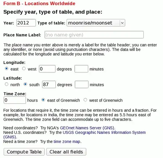

At 87 degrees south latitude on the prime meridian (0 degrees east longitude), the moon set at 0121 UTC on Nov 22 2012, and didn't rise again until 2356 on Dec 6 2012, for a total moonless period of 14 days, 22 hours, and 35 minutes. See caveats below.
You can "verify" this calculation by visiting http://aa.usno.navy.mil/data/docs/RS_OneYear.php and entering these parameters:
to get this result:
Sun or Moon Rise/Set Table for One Year

Notice that from Nov 22 through Dec 06 (non-inclusive) the rise and set are both "----", indicating "object continuously below horizon".
