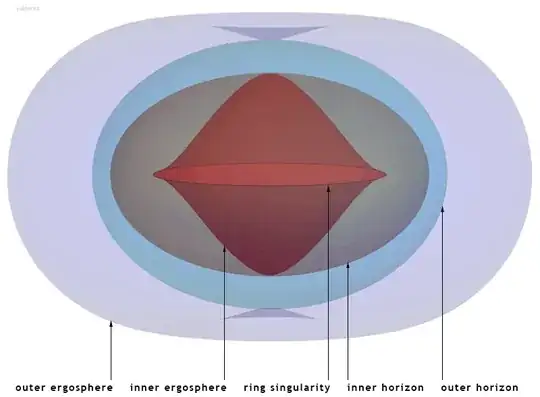

Normally, when a black hole rotates, it drags the spacetime along with it, forming a donut-like region of warped-spacetime, known as the ergosphere:enter image description here
However, if you make the black hole spin real fast, then the ergosphere starts flattening out. This effect causes the event horizon of the black hole to shrink. If it speeds up, it shrinks even more.

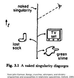

There you have it, a singularity in the nude (No NSFW reference, what are you talking about?). This naked singularity is highly erratic, as it can randomly spew out completely random (yes I am repeating that TWICE) pieces of information. To give you an idea of how erratic a naked singularity is, here is this graph/comic/idk? thingy that illustrates it.
