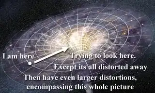

And a further image with 2D curvature illustration and verbal description.
Curvature Illustration 2D
If there were many layers of this type of effect nested, then they would all have this layered "distort your vision towards a dot / point" effect. Second image is taken from the header of this Science News Article and modified for my topic.

  • I think my argument, is that what you call isotropic, I call anisotropic, specifically because of the viewable distortion that appears to change with distance. The reason it appears uniform is because with a nested array of larger and larger distortions, all the distortions would curve the view, and cause an effect like they're all right below each other. Why the Great Attractor seems to be right behind the Milky Way, because our view is already distorted toward the galactic center, and then all view in the MW is then distorted toward the Great Attractor. – G. Putnam Jun 16 '23 at 19:34
    @G.Putnam Keep in mind cosmic expansion is measured by redshifts, not by things looking like they are motion-blurred (looking at the image you edited in) or distorted in whatever other way. In fact the Universe looks incredibly homogeneous and isotropic at large scales, so if your model predicts large-scale visual distortions, that is a problem. Anyway, the pattern of redshifts/blueshifts from falling toward a massive object would also be highly anisotropic. – Sten Jun 16 '23 at 20:34
  • Thanks for the reply. Not trying to imply motion blur with the image. Artifact of editing process, and why I included 2nd image. The stars would be too much point sources to show blur. Just wanted to show stars apparent position being distorted similar to 2nd image. My impression, would be that space would be bent enough, especially with a long chain of larger and larger distortions falling into each other (extension of 2nd image), that the effect from the 3rd, or 4th well might be so enormous, that space would look effectively spherically isotropic, because your view is curved. – G. Putnam Jun 17 '23 at 17:57
