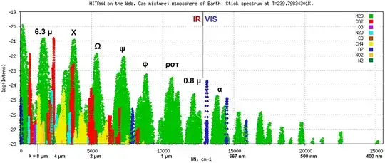

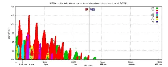

The Wikipedia page for the atmosphere of Venus has two useful graphs due to Darekk2, reproduced below, showing the absorption spectra based on simulations.
Note that there are fewer peaks in the visible range due to the lack of water and oxygen, while there is much more absorption in the infrared range due to all the CO2.
So, if there were no clouds or dust, the Venus atmosphere would be clearer than Earth's.
But at 93 bar, there is much more air to affect the light on the surface. Given that we lose about 30% of the sunlight on the way down to the ground on Earth (mostly scattered back into space than absorbed), we have about $\lambda\approx 0.3$ optical depth. The intensity reaching the ground is $I_0 e^{-m \lambda$}$ where $m$ is the air mass factor. Plugging in $\approx 93 m$ gives just $7\cdot 10^{-13} I_0$: practically all the light would disappear. Even a much lower optical depth is unlikely to change this much. At the same time this does not mean that the atmosphere is dark, it just scatters the light evenly.
So the impression I get is that, no, we would not be able to see the ground. The color of the air would be dominated by the scattered sunlight, making everything yellow.
