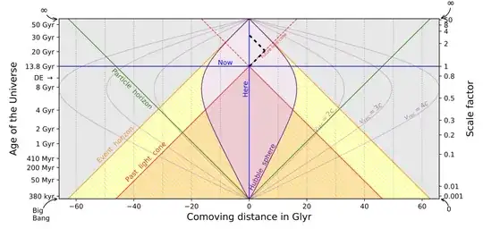

sten's answer is excellent and beautifully analytical; I just wanted to illustrate the journey and show that neglecting matter (and radiation) is a good approximation.
Spacetime diagram
To do this, I solved the full Friedmann equation numerically (well, Python's astropy did it for me) and created a spacetime diagram in comoving coordinates. A spacetime diagram show distance $d$ on the $x$ axis and time $t$ on the $y$ axis. "Comoving coordinates" means that distance is scaled with the expansion of the Universe, so that the comoving distance between objects that don't move stay the same, despite expansion. Furthermore, I scaled time such that one year on the $y$ axis is the same length in the plot as one lightyear on the $x$ axis (this is called conformal time).
A detailed explanation follows below the diagram.
spacetime
The blue lines
A point in a spacetime diagram consists of a position and a time, together called "an event". The path that something (a galaxy, a spaceship, a light ray, or whatever) takes through space and time is called its worldline. If you don't travel, you will follow a vertical line; "ours" is the blue line called "Here". If you do travel, you will deviate from vertical. Because I show distance in comoving giga-lightyears (Glyr) and time in giga-years (Gyr), and because I set the aspect ratio of the plot to [Universe-size]:[Universe-age], light rays travel on lines of 45º, so this is the maximum deviation from vertical you can do. In general, the worldline of an object moving with velocity $v$ wrt. a comoving ("stationary") object will have an angle $\theta=\tan^{-1}(v/c)$, where $c$ is the speed of light.
At any point in time, everything that happens, happens on a horizontal line. The blue horizontal line called "Now" is what happens today, so Right here, right now is where the blue lines cross.
The green line
At any point in time, light that has been able to reach us since the Big Bang must come from the region bounded by the green lines, the particle horizon (PH). Space inside the PH is called the observable Universe. Today, the PH is some 46 Glyr away, and in the future it will increase to ~63 Glyr. Remember, this is in comoving coordinates. In physical coordinates the distance will increase without bounds, but this means that we will never be able to see anything that is currently farther aways than 63 Glyr.
The red and orange lines
Everything that we see consists of events lying on the "surface" of our past light cone, given by the red line, and everything that we have ever been able to see must have been inside that, marked by the orange region. In the future, the spacetime volume of our past will increase, asymptotically reaching the event horizon (EH), marked by the orange line.
At the moment, the distance to the EH is ~16.6 Glyr. In comoving coordinates this distance will decrease. In other words, even though our observable Universe increases (because light from increasingly distant regions reaches us), the region from which we can receive information send today, decreases. In the far future, we therefore won't be able to send signals to / receive signals from any galaxies outside our local, gravitationally bound local group of galaxies.
The purple lines
The recession speed $v_\mathrm{rec}$ of galaxies increases linearly with distance. That's Hubble's law for you, $v_\mathrm{rec} = H_0 d$, with the Hubble constant $H_0$ being the constant of proportionality. This means that all galaxies inside a region of radius $d_\mathrm{H} \equiv c/H_0$ recede slower that the speed of light, while everything outside recedes faster. The region is called the Hubble sphere, and really has no particular meaning. Farther away, galaxies recede at several times $c$, marked by the purple lines.

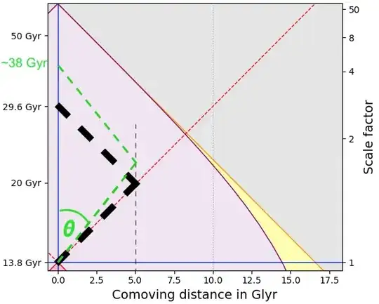

The journey from sten's example
Assuming that you can travel arbitrarily close to the speed of light (you can't because you'd get blasted by the near-speed-of-light wind of interstellar and -galactic particles, but that's a minor detail), a journey to "There and back again" will look like an "isosceles right triangle" (45º-45º-90º) with one corner at "Here & Now", apex at "There & in the future", and the last corner at "Here & even farther future". In the spacetime diagram I illustrated the journey from sten's example with a black, dashed line that has its apex at 5 Glyr. The upper corner returns to the Milky Way at $t=29.6\,\mathrm{Gyr}$, i.e. $15.8\,\mathrm{Gyr}$ from now (since the current age of the Universe is $13.8\,\mathrm{Gyr}$). This is slightly faster than sten's $17\,\mathrm{Gyr}$, and the difference is due to my calculations taking matter into account which retards the expansion somewhat for a little while yet (and possibly due to the cosmology used; I used a Planck 2018 cosmology).
Here's a zoom-in of the journey. The thinner, green, dashed line shows a similar journey, but with $v=0.9c$, so the angle with Milky Way's worldline is $\theta=42^\circ$. In this case, to go to the same galaxy 5 Glyr away and back will take longer 24 Glyr.

Maximum distance
The most distant galaxy you can visit if you want to return is found by extending the dashed line all the way to the EH (the orange line). They cross at $d=8.3\,\mathrm{Glyr}$, and this happens $t=11.8\,\mathrm{Gyr}$ from now. The journey back again then takes almost infinitely long (by assumption) and there will be no-one left to tell about your journey, so you might as well skip the return.
If you do skip the return, you might as well try and reach an even more distant galaxy. The most distant galaxy you can visit is one which is at a comoving distance equal to the end of our future light cone, i.e. where the dashed red line hit the top of the diagram. By symmetry, this galaxy is currently located at our EH, i.e. where the horizontal blue line crosses the orange line. This distance is $16.6\,\mathrm{Glyr}$.

  • Since in your calculation you account for the effect of mass slowing hubble expansion, what would the maximum go-return distance for sub-luminal speeds like, say .9c or .95c be? – user52978 Mar 08 '23 at 16:57
    @user52978 The angle of your worldline (i.e. your path through spacetime) in this diagram where light travels on 45º is given by $\tan^{-1}(v/c)$. So as your speed $v$ decreases, the (horizontal) "height" of the black dashed triangle decreases. So the difference in max. dist. compared to going at light speed is equal to the difference in height of the triangle with 45º degree corners, compared to a triangle with, say ~43.5º and 42º for $v=0.95c$ and $v=0.9c$, respectively. If I've done my trigonometry right, you'd reach a distance that's 97.4% and 94.6% of the light speed max, respectively. – pela Mar 08 '23 at 22:48
    @user52978 I edited the answer to show a subluminal journey :) – pela Mar 09 '23 at 10:07
