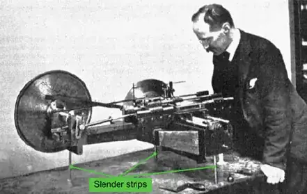

Traditionally blazed gratings were manufactured with a mechanical ruling engine.
H. A. Rowland with his ruling engine for diffraction gratings (Jones 1988)
Source: Researchgate, chapter Compliant Manipulators in book: Handbook of Manufacturing Engineering and Technology (pp.1-64) Publisher: Springer Editors: Andrew Nee (2014)
Groove placement was controlled by incrementing a drive screw, and gratings were plagued by spatial variations corresponding to complete rotations of this screw.
So the improvement of grating resolution was, at least during some period of time in the history of spectroscopy, controlled by these drive screws and techniques to overcome periodic variations in groove phase.
Once laser interferometers and quadrature detection and active feedback became available in manipulation and mechanical translation, manufacture of blazed gratings was no longer limited in resolution by the screws that drove the instrument.
