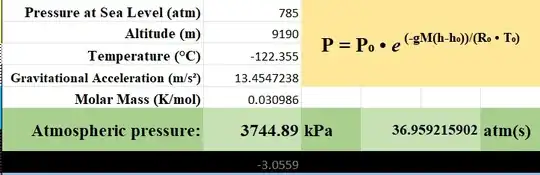

I built a calculator to calculate a planet's atmospheric pressure at an altitude with the formula below.

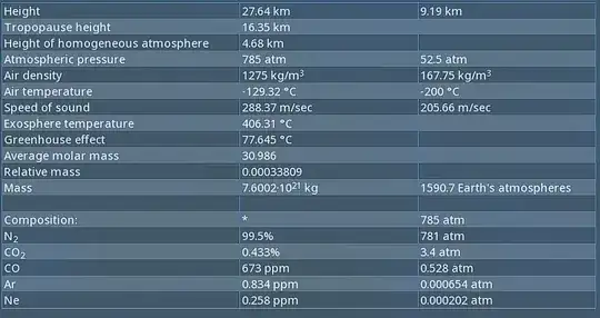

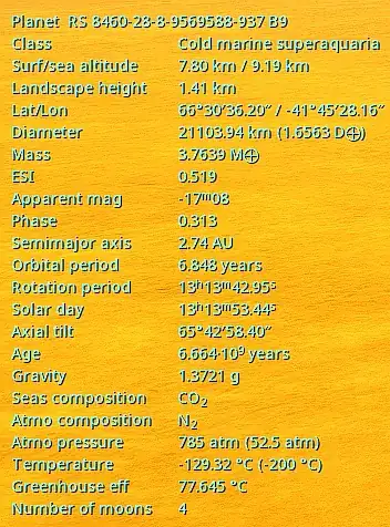

I compared the results with the in-game data including same input data but it becomes less accurate the farther it is from sea level so something might be missing behind the scenes.
Heres the ingame data:
And my calculator results:
As you can see, the atmos pressure in the in-game data and calculator are not reasonably close enough, maybe I could accept at least around ±1

Apparently, the game was more of an emulator rather than a simulator, it could just make up data to make it seem believable and consistent with findings instead of full calculations.
