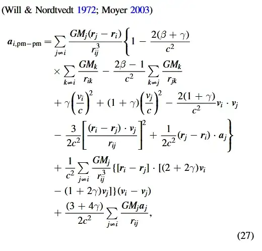

More recently the following Equation 27 is reported in Park et al 2021, The JPL Planetary and Lunar Ephemerides DE440 and DE441. It is similar in parts to the Yeomans Equation but it accounts for the gravitational effects of multiple sources. Note that in Equation 2 of Parks et al, the term $r_{ij}=|\textbf{r}_i-\textbf{r}_j|$ is defined as an unsigned scalar value representing the distance between bodies $i$ and $j$.
D440-D441 Ephemerides Eqtn 27

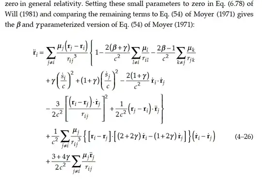

A very similar equation is presented in Descanso2 Section 4-26. It is based on work by Moyer (1971) and Will(1981). Here $\mu = GM_{body}.$ Note that the typescript in this image makes it easier to tell the difference between vectors and scalars than in the image of the Park et al 2021 Equation 27.

The Park et al eqtn 27 can be applied to the imaginary case of a test particle (i) in an orbit (with orbital radius and speed similar to a terrestrial planet) around the Sun where the Sun (j) is the only gravitational source in the system. In General Relativity the terms $\beta$ and $\gamma$ are equal to 1. By taking the inertial frame and coordinate system where the position ($r_j$) velocity ($v_j$) and acceleration ($a_j$) of the Sun are zero we find that many of terms become zero.
$$\textbf{a} = \frac{-GM.\textbf{r}}{r^3} \left( 1 - \frac{4.GM}{c^2.r} - 0 + \frac{v^2}{c^2} + 0 -0 -0+0 \right) + \frac{GM}{c^2.r^3}\left( [\textbf{r}] \cdot [4.\textbf{v}-0]\right)\textbf{v} +0$$
And so...
$$\textbf{a} = \frac{-GM.\textbf{r}}{r^3} \left( 1 - \frac{4.GM}{c^2.r} + \frac{v^2}{c^2} \right) + \frac{4GM}{c^2.r^3}\left( \textbf{r} \cdot \textbf{v}\right)\textbf{v}. $$
... which is identical to my Equation 1 derived from Equation 3.11 of Shaid-Saless & Yeomans 1994.
(Note that the third term inside the curly braces of Park et al's Equation 27, the sum of objects $k$ does not exclude object $i$. But I have ignored this term as the mass of object $i$ relatively very small in this case. The omission appears valid when the Non-Newtonian part of the above equation is compared with Equation 20 from Moyer 1971, Mathematical Formulation of the Double Precision Orbit Determination Program DPODP for the motion of a 'massless' test particle around a single massive body.
