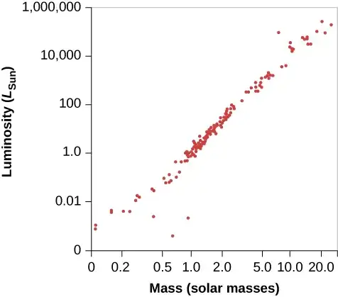

For stars on the main sequence, there is a mass-luminosity relationship
Sourced from (Astronomy by Openstax and Department of Physics and Astronomy at Douglas College, Chapter 18.2 Measuring Stellar Masses cc-by
From this an estimate of the mass can be made. If one can also estimate the age of the star, the estimate can be improved. For stars that are off the main sequence, estimating the mass may be much harder, and depend on a model of stellar evolution. Moreover, as luminosity estimates depend on distance, uncertainty in the distance of stars can be a significant source of uncertainty in their mass.
For a star like Betelgeuse, estimates of the mass range from 9 to 21 solar masses (with older models suggesting as much as 30 or as little as 5 solar masses) (see Wikipedia). It can be said that for such stars, it is not possible to determine the mass, only to make a broad estimate of a range of possible masses.

1But wouldn't that main sequence also be mostly derived from estimates? – curiousdannii Dec 22 '22 at 23:20
5It's derived from observations of binary stars, for which accurate masses can be determined. – James K Dec 22 '22 at 23:22
With difficulty. < I know! It keeps rolling off of the scale. (didn't want to make light of your answer, and the diagram is great.)
– J. Gwinner Dec 23 '22 at 22:05
