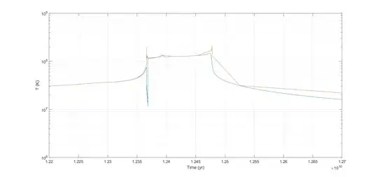

Here is what I get when I run MESA-Web for the sun, zooming in on the red giant period (top plot: core temperature, middle: triple alpha luminosity, bottom: surface luminosity).
Simulated red giant stage
When the process sets in, the core temperature rises (after oscillatory transients) to 110 million K, ramping up to 147 MK near the end.
The maximum temperature is however not always in the core, but sometimes in a shell surrounding it. Plotting it versus the core temperature shows there are periods where the shell reaches 200 million K.
Core (blue) and maximal shell (red) temperature
