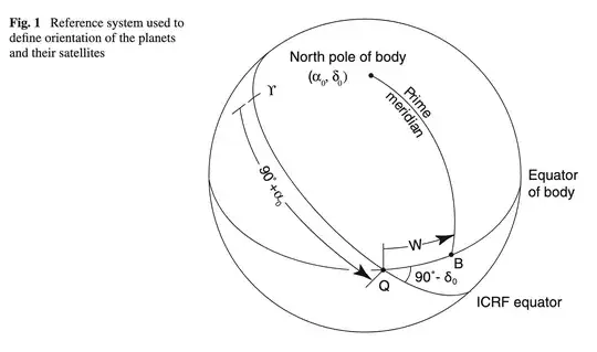

This question about the direction of rotation is a bit ambiguous, as "direction" can be interpreted as retrograde/prograde -or- as the direction of the north pole axis.
This answer is about the direction of a planet's axis of rotation. When it comes to the direction of the rotation, the method that most people use is described in the following paper:
Cartographic Coordinates and Rotational Elements
Essentially, the idea is to calculate de right ascension and declination values of the north pole of each planet using formulas described in the document. Each formula is planet specific, due to its unique interactions with other bodies in the solar system. The values of the right ascension and declination are expressed using the planet's ecliptic equator (the intersection of the sphere and the International Celestial Reference Frame (ICRF), which is fixed to the stars and centered on the solar system barycenter).
enter image description here Once, the north pole is determined, the equatorial plane can be deducted (the plane orthogonal to the vector defined between the north pole and the planet center and containing the planet center) as well as the line of nodes that define the intersections of the ICRF plane and the planet's equatorial plane.
The last step is to properly orient the north pole to a given direction. This is achieved by calculating the angle W that specifies the position of the line of nodes. Again, the formula to calculate the value for W is planet specific. Using the value of W, the north Pole axis can be rotated around the ICRF z-axis (0,0,1), to position the line of nodes properly.
In each formula, the right ascension, the declination, and the position of the prime meridian are calculated using:
  • T = interval in Julian centuries (of 36525 days) from the standard epoch J2000
  • d = interval in days from the standard epoch J2000
  • The standard epoch is JD 2451545.0, i.e. 2000 January 1 12 hours TDB
