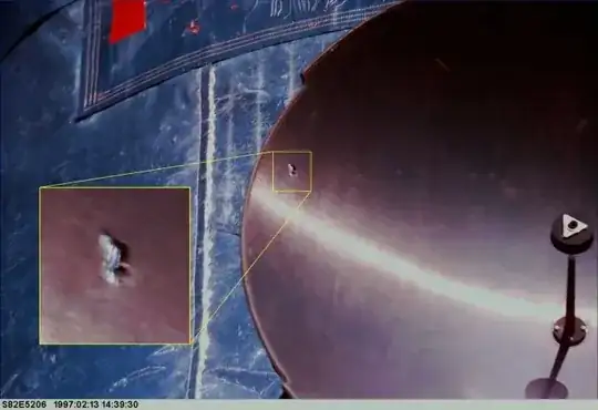

Below is an image showing micrometeoroid / orbital debris (MMOD) damage to the Hubble during the second Hubble repair mission in 1997. The micrometeoroid or orbital debris that caused that damage passed completely through the mirror. The primary mirror was never replaced during subsequent Hubble repair missions. Despite this damage, the Hubble has continued to deliver very high quality in the 25 years (and probably more) that followed this impact. One MMOD impact is not something to worry about.
Image showing an impact hole left in the Hubble Space Telescope antenna in 1997

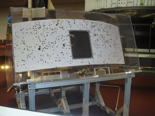

Portrayed below is an image of the radiator on the Hubble telescope's Wide Field and Planetary Camera 2 (WFPC2).
The Hubble telescope's Wide Field and Planetary Camera 2 (WFPC2) was installed in 1993 during the first Hubble repair mission. This was the camera that saved the Hubble. The WFPC2 was replaced with the Wide Field and Planetary Camera 3 (WFPC3) during the fourth Hubble repair mission because camera technology had improved immensely during the intervening 15.5 years. The WFPC2 was brought back to Earth for studies. What is shown in the photo below is the WFPC2 radiator after the numerous MMOD impacts were drilled out for study. The size of the holes greatly magnifies the magnitude of the impacts. It's the number of holes that is relevant in the image.
WFPC2 radiator after being brought back to Earth and studied for MMOD damage. The WFPC2 radiator suffered lots and lots of MMOD impacts.

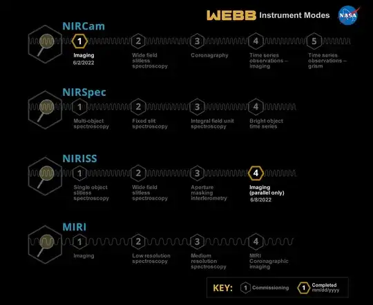

The image below shows very precisely what checkout procedures still needed to be done as of 8 June 2022. Each of the four instruments on the JWST has multiple modes of operation. Each of those operational modes must be checked out and signed off before the instrument is deemed to be operational. As of 8 June 2022, only 2 of the 17 instrument modes had been fully confirmed and signed off. The final commissioning checkout procedures of those remaining 15 modes is what the article was referring to. The goal is to have all of this commissioning work (and signed off) completed by 12 July 2022. This checkout has absolutely nothing to do with the micrometeoroid impacts.
Checkout procedure diagram. As of 8 June 2022, the NIRCam and NIRISS had had one mode each deemed to be "commissioned"; 15 modes remained uncommissioned as of that date.

    OT, but is there some significance to those sine waves behind the hexagons in that image? Specifically curious why the MIRI one appears to have a longer period than the other 3. I'd say it was something like "number of orbits before we do this", but #4 is already complete on NIRISS before #1-3, so that doesn't seem to mean anything. – Darrel Hoffman Jun 10 '22 at 17:35
  • @uhoh The title of the question asked Has the small meteorite that hit Webb done a lot of damage? That most definitely is a very emphatic no. NASA long ago gave up on whitewashing problems. Recently, NASA has been very upfront when an astronaut on an EVA has their helmets start to fill with water, or when an automated spacecraft fails to deploy, or when a Mars rover gets stuck or damaged. The truth would come out in a month if the micrometeoroid had caused a "lot of damage" when NASA said the damage was at most minimal. – David Hammen Jun 10 '22 at 18:40
  • @uhoh Regarding the second question, How seriously must we take this? That again deserves an emphatic no, at least for now. Over the course of the next decade or two, the accumulation of MMOD damage is one of the many ways the JWST might fail over time. The damage from just one micrometeoroid is not something to worry about now. – David Hammen Jun 10 '22 at 18:46
    @DarrelHoffman It indicates the IR frequency (or wavelength) at which the various instruments observe. The NIRCam, NIRSpec, and NIRISS all observe in the near infrared (NIR), hence their names. The MIRI observes in the mid-infrared. Observing in the mid-infrared requires rather low temperatures. – David Hammen Jun 10 '22 at 19:26

  • I would love to see a photograph of the WFPC2 radiator before it was drilled or of the sampled cores. NASA inspection report (PDF) – Dennis Williamson Jul 11 '22 at 23:42
  • The first photo shows damage to Hubble's antenna, but the text makes it sound like it shows damage to the primary mirror. – 2012rcampion Jul 13 '22 at 23:53

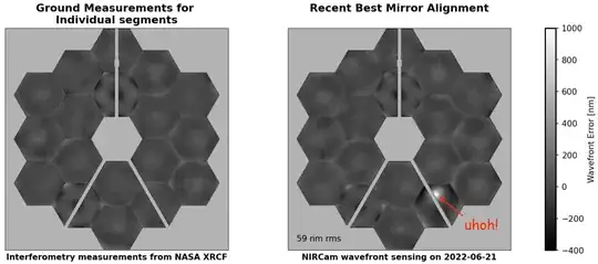

Source (annotated)
Figure 3: Wavefront Sensing Measurements showing the quality of achieved mirror alignment on orbit. The telescope wavefront error achieved in flight, shown in the right panel, closely tracks the as-polished surface figures of the individual segments, as measured during ground testing years ago, shown in the left panel. JWST’s wavefront sensing and mirror control systems are working as intended, achieving optimal alignments within the ~10 nm resolution of the sensing and control system and correcting as necessary to maintain that alignment. Data from PID 1163.
Despite the "emphatic no" and "emphatic not at all, at least not for now." in @DavidHammen's answer, I think there is room to argue that there is some important significance to the event and its result, and I have a hunch that they'll likely make some prudent modifications to the observing schedule.
Space.com's James Webb Space Telescope picture shows noticeable damage from micrometeoroid strike links to the arXiv preprint Characterization of JWST science performance from commissioning and section 4.7 Micrometeoroids includes the following:
...Of the six micrometeoroid strikes detected thus far through wavefront sensing, five had negligible effects, contributing a combined total of < 1 nm to the overall wavefront error.
By contrast, the micrometeoroid which hit segment C3 in the period 22—24 May 2022 UT caused significant uncorrectable change in the overall figure of that segment. However, the effect was small at the full telescope level because only a small portion of the telescope area was affected. After two subsequent realignment steps, the telescope was aligned to a minimum of 59 nm rms, which is about 5-10 nm rms above the previous best wavefront error rms values7. It should be noted that the drifts and stability levels of the telescope mean that science observations will typically see telescope contribution between 60 nm rms (minimum) and 80 nm rms (where WF control will typically be performed). Further, the telescope WFE combines with the science instrument WFE to yield total observatory levels in the range 70-130 nm (see Table 2), so the slight increase to telescope WFE from this strike has a relatively smaller effect on total observatory WFE.
7The impact raised the wavefront error of segment C3 from 56 to 280 nm rms. Mirror commanding to adjust segment position and curvature reduced this error to 178 nm rms. This, after dividing by area and adding in quadrature to the other sources of WFE in the telescope, results in ~9 nm rms increase to the total telescope wavefront error.
In other words, the initial event had a significant impact on the contribution from one of the 18 mirrors. Some of that was reduced by two subsequent realignments of (at least) that segment, and the overall WFE or wavefront error for the whole mirror (all 18 segments together) only increased a little bit.
