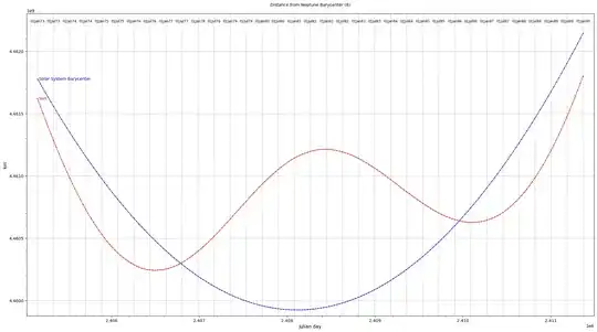

The last perihelion passage of the Neptune system barycentre relative to the Solar System barycentre (SSB) was at 1881-Feb-02 10:00 TDB.
Here's a plot (courtesy of JPL Horizons) of the distance from the Neptune barycentre to the Sun and to Solar System barycentre for a couple of decades around that date. The vertical axis is the distance in billions of kilometres.
From: 2405159.5 A.D. 1873-Jan-01 00:00:00.0
To: 2411368.5 A.D. 1890-Jan-01 00:00:00.0 Neptune distance to Sun & SSB
As you can see, relative to the Sun, there was actually a local maximum distance near that date, around 6 years after Neptune's closest distance to the Sun, and another local minimum around 5 years after that. The distance to the SSB behaves more like we expect from a nice elliptical orbit.
I created that plot using my script here.

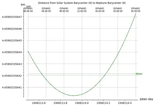

Zooming in,
From: 2408113.5 A.D. 1881-Feb-02 00:00:00.0
To: 2408114.5 A.D. 1881-Feb-03 00:00:00.0
Neptune periapsis
That's a plot for the distance from the Neptune barycentre to the SSB. If you want to search for the closest distance for the Neptune body centre, you can use this script, setting 899 as the target. If you want the distance to the Sun, use @10 as the centre. There are brief instructions on using the script here.
Here's a link for the Horizons data used for the last plot. And here's the raw data:

As Barry Carter mentions in a comment, the orbit of Neptune is nearly circular. Its mean eccentricity is ~0.009, a little over half that of Earth's orbit. So perturbations by the other giant planets (on Neptune and on the Sun) can have a significant effect on the time and position of perihelion and aphelion. And that can have interesting effects on Neptune's mean and true anomaly (which are measured from the perihelion).
Although real orbits aren't perfect ellipses, it can be useful to treat orbital motion as an ideal Keplerian orbit that changes over time. This is known as the osculating orbit
the osculating orbit of an object in space at a given moment in time is the gravitational Kepler orbit (i.e. an elliptic or other conic one) that it would have around its central body if perturbations were absent. That is, it is the orbit that coincides with the current orbital state vectors (position and velocity).
Horizons can produce ephemerides of osculating orbit elements. Here's a plot of the eccentricity of the Neptune barycentre, relative to the Sun, for (roughly) one orbital period, with a step size of 2 calendar months. As you can see, it varies quite a bit, and gets extremely low at times.

    Thanks you so much ! Your work is awesome. I'm grateful to you that you have spend time on my question. This was exactly the answer I was needing. – LittleCoder May 03 '22 at 20:12
  • @LittleCoder No worries. With a bit more zooming in, it looks like the perihelion is around 1881-Feb-02 10:10 TDB. But the data starts to get "blocky", and my plotting script behaves oddly if I zoom in too much. – PM 2Ring May 04 '22 at 18:49
  • Just to add a reference, Neptune's orbit is nearly circular: https://astronomy.stackexchange.com/questions/28691/why-is-neptune-true-anomaly-decreasing/28704#28704 -- upvote for using the HTTP GET protocol with HORIZONS, a cool sneaky backdoor trick :) And, just to beat this to death, you can use https://wgc.jpl.nasa.gov:8443/webgeocalc/#NewCalculation to find the "exact" times of periapsis and apoapsis – Barry Carter May 05 '22 at 13:47
  • Thanks, @barry I should mention the difficulties associated with Neptune's low eccentricity to my answer. WebGeoCalc looks interesting! Using GET with Horizons is well-documented: https://ssd-api.jpl.nasa.gov/doc/horizons.html but annoyingly, some of the query parameters that work in batch files (and which the Horizons Web interface prints) don't work in GET query strings, you have to use the newer synonyms. – PM 2Ring May 05 '22 at 18:14
  • @LittleCoder I've updated my answer with some info you may find useful. – PM 2Ring May 05 '22 at 20:17
  • Yes, thanks you so much for your details. And thanks you also for editing my question, on my French keyboard I didn't saw my typo. – LittleCoder May 05 '22 at 21:29
  • @LittleCoder Using WebGeocalc, the time of perihelion (of the Neptune barycentre) is 1881-02-02 10:09:54.295 TDB = 10:09:13.110 UTC. Good luck with your simulator! It's probably a good idea to learn a bit about Horizons (or WebGeocalc), so you can use it to check the accuracy of your sim's calculations. FWIW, Jean Chapront, Michelle Chapront-Touzé, et al, used the JPL DE to develop the Éphéméride Lunaire Parisienne. – PM 2Ring May 07 '22 at 01:26
