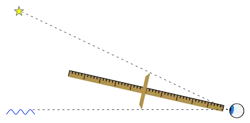

A tool such as Jacob's staff or a cross-staff can be used. This is essentially two pieces of wood in a cross shape, one of which can slide on the other.
By Original: Fantagu Vector: Majo statt Senf - Own work based on: Jakobsstab3.jpg, CC BY-SA 4.0
By aligning the arms of the cross to the two stars you can find the angle between them.
A practical variation of this is the Sky Ruler (from BBC Sky at Night magazine). This is marked in degrees, so you don't need to do any trigonometry, and is made of card so you don't need carpentry skills.
