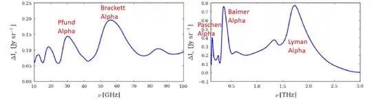

There should indeed be emission lines at the appropriately redshifted frequencies. However, they are going to be incredibly faint and diluted because the ratio of photons to baryons at the epoch of recombination was more than $10^9$. i.e. There were more than a billion photons (distributed in a blackbody spectrum) already present for every proton $+$ electron recombination event.
Further, because recombination did not occur at exactly one redshift, but over a range of redshift, from perhaps $900<z<1300$, the recombination lines are smeared out in the frequency spectrum.
A calculation of the size and shape of the recombination lines is given by Sathyanarayana et al. (2015) (which is a paper actually putting forward a proposal to try and detect these lines). I've labelled some of the main recombination lines, which are an additive contribution to the main CMB spectrum. The y-axis is in units of Jy/sr. For comparison the CMB spectrum peaks is about $300\times 10^6$ Jy/sr at $\sim 100$ GHz. So these lines are fluctuations of order 1 part in $10^9$ in accordance with the arguments above. Current instrumentation is capable of detecting spectral intensity deviations of something like 1 part in $10^5$ so these features are many orders of magnitude below current detection thresholds.
Recombination spectrum. Recombination spectrum predicted from the CMB. This is to be added to the main CMB continuum, which is about 9 orders of magnitude brighter [adapted from Sathyanarayana et al. (2015)].
