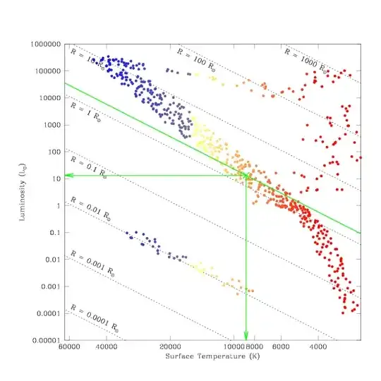

By knowing $a$ (based on my randomly selected mass) it seems that I can derive the star's luminosity. By glancing at the Hertzsprung–Russell diagram (e.g. this one) I can see that I can perhaps somehow calculate the radius of the star, but I'm not entirely sure how.
