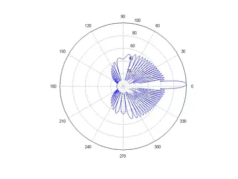

  1. Arrays of radio telescopes are not only steered mechanically, but are also steered mathematically by applying signal delays before the signals are combined. The clever application of signal delays can create constructive interference in the region of interest while creating dampening (destructive) interference for signals outside of the region of interest. Credit: Maxter315 wikipedia: enter image description here
