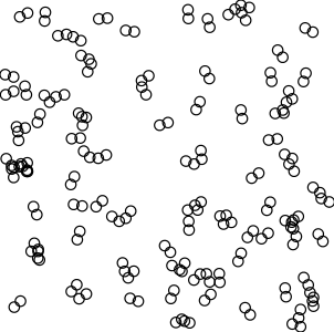

GrapefruitIsAwesome has already explained why the sky is significantly larger than 3300 square degrees; I'd like to explain why the sky coverage is precisely the value it is.
The wording is admittedly not ideal. The portion of the sky visible to the surveys are limited by 1) dust in the Galactic plane that prevents them from observing extragalactic sources beyond it, and 2) the finite declination range of a given telescope, arising from both its latitude and the limits on its elevation range.
Dey et al. 2019 provide basic parameters of the DESI surveys; that $\approx14,000$ deg$^2$ area is defined to be the portions of the sky with galactic latitudes above $15^{\circ}$ (the Galactic plane at work) and declinations of $\delta>-20^{\circ}$ (the limit imposed by the position of Kitt Peak, one of the observing sites). Dust in the plane actually cuts this into two separate regions, the North Galactic Cap and the South Galactic Cap, which together have the total area listed. Even this is in fact slightly modified even further, to "minimize scheduling issues" and to avoid regions with more stars - not an excellent thing to have in an extragalactic survey.
Here's what this ultimately looks like (Fig. 1, Dey et al.), with the regions surveyed outlined in red. The other shading and labels denote coverage by other spectroscopic surveys.
Image showing northern sky (and part of the southern sky) covered by DESI, which appears as two separate chunks.
