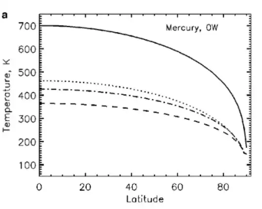

There is an analysis of the surface temperature of Mercury by David Paile from UCLA. It shows the yearly (and also diurnal) variation in surface temperature (solid line in the plot. The other broken lines are for different depths). There is a large amplitude at the equator, and a much more shallow one near the poles. The diurnal temperature variation on Mercury were plotted by VASAVADA, PAIGE, AND WOOD (1999): "Near-Surface Temperatures on Mercury and the Moon and the Stability of Polar Ice Deposits". The solid curve is the maximum surface temperature near perihel as a function of lattitude. Near aphel the maximum surface temperature near the equator is about 120°C less, but the maximum temperature near the pole does not change.
Diurnal temperature variation on Mercury. VASAVADA, PAIGE, AND WOOD (1999): Near-Surface Temperatures on Mercury and the Moon and the Stability of Polar Ice Deposits
